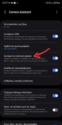

supermario Δημ. February 2, 2024 Δημ. February 2, 2024 (edited) ναι παιδιά το βίντεο είναι τραβηγμένο απο το κινητό μου... και φαίνεται τόσο εμφανές σε πολυ κοντινο αντικειμενο...όπως βλεπετε στο βιντεο... και αναρωτιέμαι είναι νορμαλ αυτό?ετσι κάνουν όλα? (PS ειναι τοσο εντονο με ενεργοποιημενη την επιλογη αυτοματη εναλλαγή φακού απο το camera assistant) δεν μου το κανει στο βίντεο αλλά στις φωτογραφίες (το ανωτέρω βιντεο είναι απο καταγραφή οθόνης του κινητου) Edited February 2, 2024 by supermario Παράθεση http://forum.xda-developers.com/lg-g3

Athkatla Δημ. February 2, 2024 Δημ. February 2, 2024 7 minutes ago, dextergsxr said: Το κάνει όταν η κάμερα κοιτάει σε κοντινά αντικείμενα Επιβεβαιώνω. Από Reddit: For those who don't know how the Samsung image system works, this is a full on false flag, nothing more. If you read about what "auto lens switching does", it can keep using the original physical lens instead of switching to a different ones in certain conditions, such as dark conditions, or, wait for it, close up objects. So in the first example, the "defective phone" you see that auto lens switching is turned off, when he switches to 3x and 5x, the camera doesn't think if it is maybe better to crop the main camera, do what the person asks. In the store example, that default option is on, so it just uses the 1x camera and crops that to 3x and 5x. You can clearly see in the video that perspective doesn't even switch a millimeter when he goes through the zoom range, indicating that the lens is in the exact same physical location. Even the best AI can't fake that. So, TLDR: the "broken phone" actually switched physical lenses, while the store one cropped the 200mpix main sensor. Nothing to worry about here, just baseless fear mongering as always. There will always be a shift in perspective when switching between lenses with different optical properties and more important, locations. You can only get a smooth zoom if you have a physical lens that can change focal lengths, or as in the video, you use a crop from the main camera. 200mpix is plenty to get a decent image even at 5x crop, that is whtpy the phone sometimes uses that instead of the other 5x sensor. 2 1 Παράθεση

Cloud Δημ. February 2, 2024 Δημ. February 2, 2024 (edited) Μέσω του Camera Assistant η ρύθμιση. Απορώ οι Ινδοί πως και γιατι το αναγνώρισαν ως πρόβλημα... Edited February 2, 2024 by Cloud Παράθεση Life Is Good
