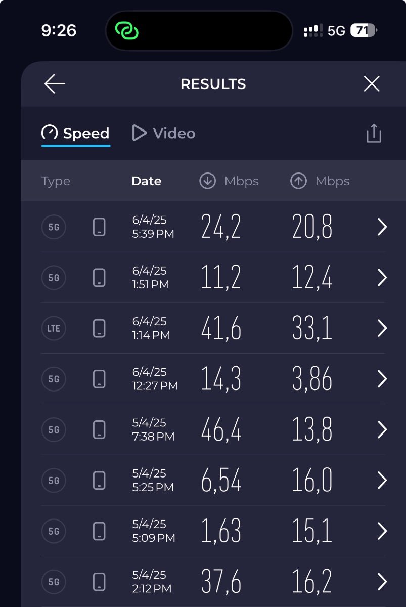

1 minute ago, Harry636 said:
3 ώρες πριν, Harry636 said:
